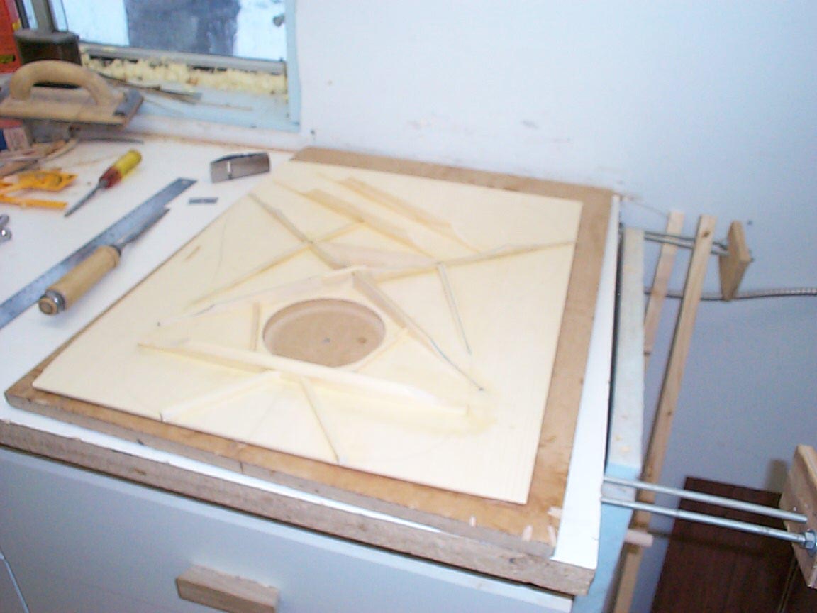

This may help to "settle down" bridge rotation.
You might want to try it.
It's easily fitted immediately behind the bridge plate, easily removed, and doesn't need the CF lamination.
From a master of the dreadnought/bluegrass guitar, Mario Proulx - "the PMTE. The little brace behind the bridge plate was nicknamed the "Proulx Magic Tone Enhancer" by Bryan Kimsey, who was the first person who noticed it. It's "magic" because, in theory, it should ruin the guitar, but instead, it really does liven things up.
For two reasons: first, it stiffens the bridge plate area, but most importantly, it adds some mass where it can do the most good. Yes, mass is good, in the right place......"
These users thanked the author Colin North for the post (total 2): Barry Daniels (Sat Jan 15, 2022 6:46 pm) • G.Cummins (Wed Nov 10, 2021 6:22 am)
It would be interesting to see a full image of that because it looks like the X-brace angle is wide open and also almost looks like possibly 3 lower tone bars? That one that joins up to the bridge plate looks very high up on the X.

jfmckenna wrote:
2 tone bars but almost Lowdonesque? finger braces -

Colin North wrote:
jfmckenna wrote:
http://www.proulxguitars.com/buildup/images/rosettes%20and%20purflings/DCP03892.jpg
Ah ok that's different for sure.

Alan Carruth wrote:
.............. The epoxy binder in the vertical webs that North shows in his photo may well creep in shear under load..............
Maybe someone should warn Mario Proulx about that.
I'm keeping my head down!
