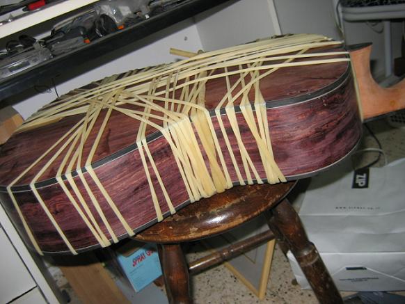

Many years ago when I first started flying RC airplanes I was able to buy rubber-bands to attach top mounted wings to the fuselage that were made of surgical rubber (the yellowish near translucent rubber) They were much stronger and did not decay as fast as the light brown rubber that is used on most heavy duty rubber-bands today.
Any way I have just set up a new binding station and want to getaway from using tape and CA. and go back to an open time adheasive like fish glue. I am having a hard time finding rubber-bands that are really up to the task for more than one or two usages. I am hopping to find a supplier of bands made from surgical rubber rather than the cheap rubber that most heavey duty rubber-bands seam to be made of these days.
Anyone have a link?

Actually it is not surgical rubber that I was looking for but rather a UV treated natural rubber and thicker than normal. the standard #62 and #64 rubber bands are only .04 thick the ones I was looking for are .08 thick and are referred to as high load industrial. available in synthetic or natural rubber and non-UV treated or treated. Come to find out the near translucent ones I was thinking of are treated with silicon so I think maybe I will for go them
PostPosted: Thu Jan 10, 2008 5:28 am
i would recommend avoiding anything treated with silicone. you may find some silicone transference problems down the track.

lee valley has something similar.
i've been using it for about 2 years now without any problems.

I went to the local Rubber and Gasket Supply and bought about 60 ft. of neoprene rubber 1/8" X 2". I've never used it but I keep it in a cabinet out of the sun. Also I don't know if theres any silicone in it. It splices great with CA. The supply house cut it to my specs from a big roll. I plan on using it this spring.

Just a word of warning - I got some 4" wide exersize banding when I hurt my shoulder and thought it would work well for wrapping binding. The color (yellow) leached onto my top and was very difficult to get rid of.

Thanks Charlie. [:Y:] i was actuall looking specificly for rubberbans made from the same translucent rubber as surgical tubing. not surgical tubing. Years ago when I first started flying RC airplans there was a manufacture that sold rubberbans as I described. The were much stonger and much more uv resistant than the ones you find at hobby store these days. I found several boxes of them at a local RC hobbiest house so I am good to go. they are still made by the way but I forget the name of the company. I will look at the box when I get home. the are also used in scuba harpon guns. Some use tube some use these rubberbands.
